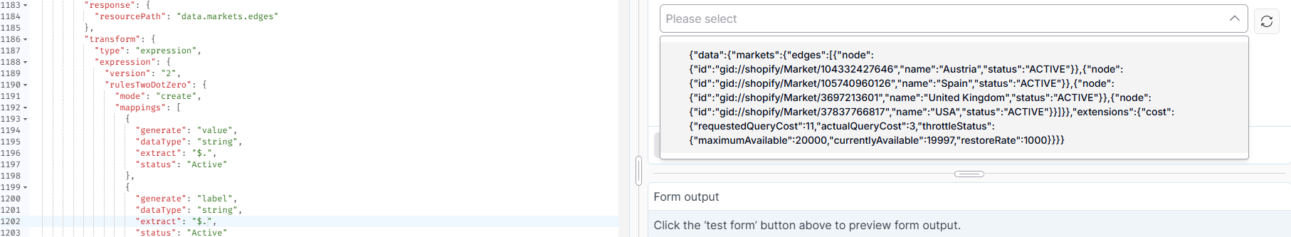

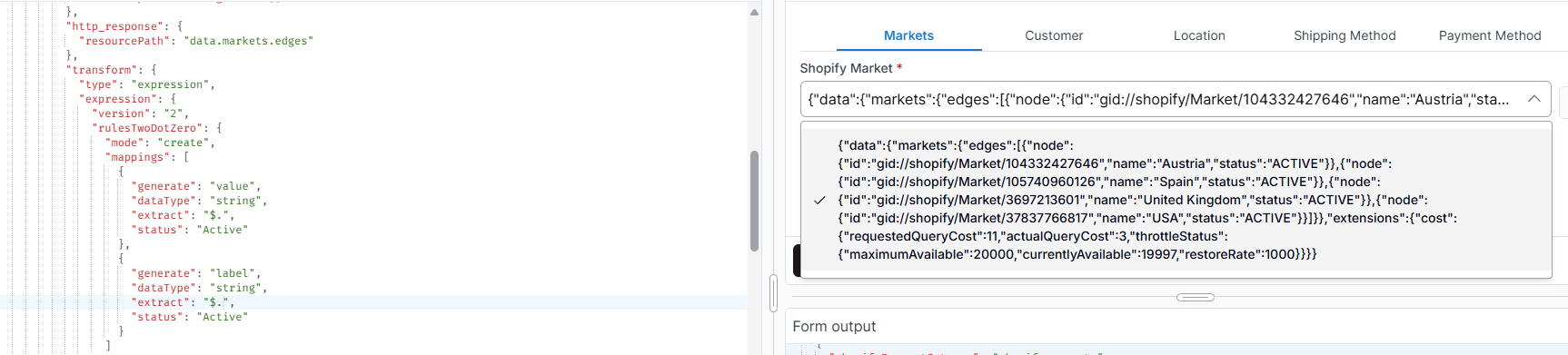

If I sent the resource
          "http_response": {
            "resourcePath": "data.markets.edges"
and set the fields to just $.
I get the whole response:
{\"data\":{\"markets\":{\"edges\":[{\"node\":{\"id\":\"gid://shopify/Market/104332427646\",\"name\":\"Austria\",\"status\":\"ACTIVE\"}},{\"node\":{\"id\":\"gid://shopify/Market/105740960126\",\"name\":\"Spain\",\"status\":\"ACTIVE\"}},{\"node\":{\"id\":\"gid://shopify/Market/3697213601\",\"name\":\"United Kingdom\",\"status\":\"ACTIVE\"}},{\"node\":{\"id\":\"gid://shopify/Market/37837766817\",\"name\":\"USA\",\"status\":\"ACTIVE\"}}]}},\"extensions\":{\"cost\":{\"requestedQueryCost\":11,\"actualQueryCost\":3,\"throttleStatus\":{\"maximumAvailable\":20000,\"currentlyAvailable\":19997,\"restoreRate\":1000}}}}
Any ideas?

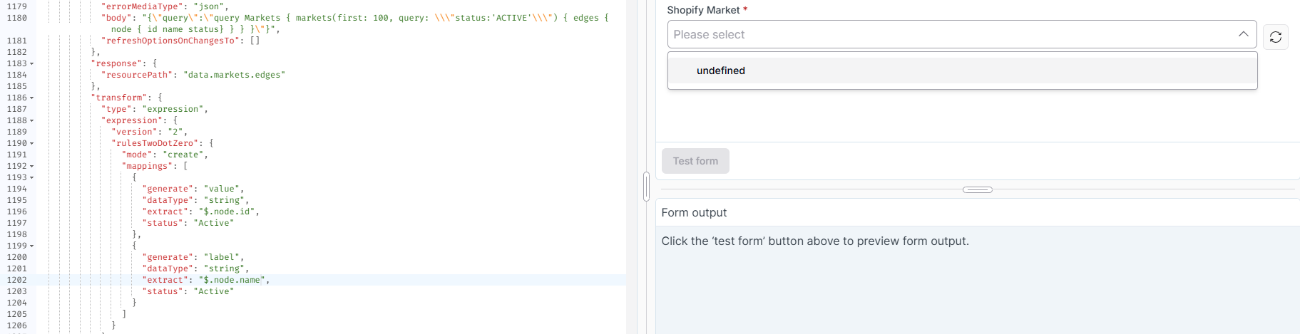

@sreevaniamara, thanks again for coming back to me.
With the configuration you suggested, still getting “undefined” in the dropdown.
Here is the full fieldmap….
"shopifyMarket": {
      "id": "shopifyMarket",
      "name": "shopifyMarket",
      "type": "exportSelect",
      "label": "Shopify Market",
      "required": true,
      "resource": {
        "virtual": {
          "_connectionId": "68fe21adb2c1c834222f53a9",
          "asynchronous": true,
          "oneToMany": false,
          "http": {
            "method": "POST",
            "formType": "graph_ql",
            "isRest": false,
            "requestMediaType": "json",
            "successMediaType": "json",
            "errorMediaType": "json",
            "body": "{\"query\":\"query Markets { markets(first: 100, query: \\\"status:'ACTIVE'\\\") { edges { node { id name status} } } }\"}",
            "refreshOptionsOnChangesTo": []
          "response": {
          "transform": {
            "type": "expression",
            "expression": {
              "version": "2",
              "rulesTwoDotZero": {
                "mode": "create",
                "mappings": [
                    "generate": "value",
                    "dataType": "string",
                    "extract": "$.node.id",
                    "status": "Active"
                    "generate": "label",
                    "extract": "$.node.name",
                    "status": "Active"
If I remove the $.node.id and the $,node.name and leave as $. The dropdown is showing the response as previously advised.
