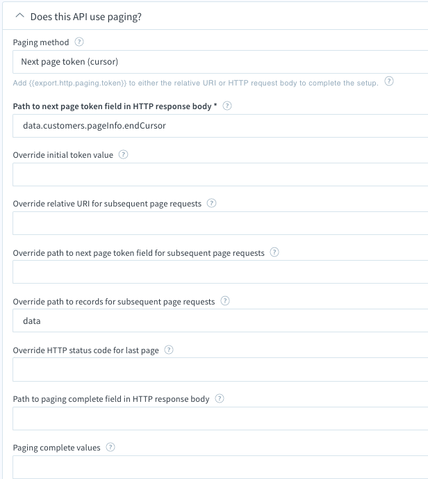

In the export step, you can then build the GraphQL queries - see below for example:
query ($var: Int!)
customers(first: $var, query:"accepts_marketing:true" {{#if export.http.paging.token}}, after: "{{export.http.paging.token}}" {{/if}}) {
pageInfo {hasNextPage endCursor}
edges {
node {id,firstName,lastName}
The above example uses the following pagination set up
Thanks
