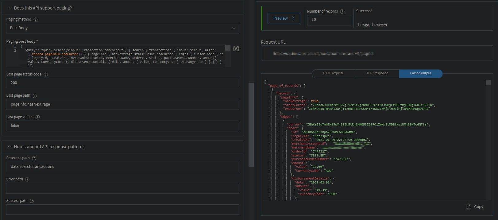

To test the connection, define the parameters as follows.
Ping Method: POST
Ping Body: { "query": "query { ping }" }
5. Create an integration flow, where Braintree is one of the imports.
Here's an example flow
Define the import to Braintree, as described below.
Name: Braintree - Capture Transaction
Input Mode: Records
Method: POST
Request Media Type: JSON
Response Id Path: (e.g. /data/transaction/id)
Error Path: /errors
Success Media Type: JSON
Error Media Type: JSON
