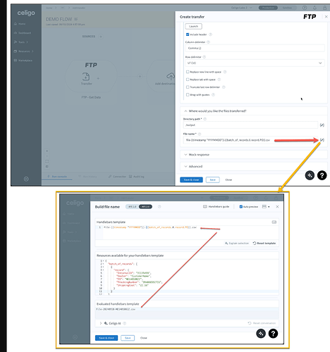

Just to be clear is your use case that you are wanting to get the CSV from an FTP location and then for each line on the CSV create a single CSV file in a different FTP location/directory?
As for the file name conventions. Yes you you could use a handlebar function in the file name field in order to get the name as you need.
similar to this example. You may have to modify your formula a bit in order to get it the way you need.
file-{{timestamp "YYYYMMDD"}}-{{batch_of_records.0.record.PO}}.csv

Good day! We resolved the issue by using the parameter on our source tile "How many records would you like to export?" and set it to 1. Then we will just run the flow every 15 mins.
We also used the handlebar expression for the filename to be "Shipment-{{timestamp "YYYYMMDD_hhmmss" "America/Chicago"}}-{{batch_of_records.0.record.PO}}.csv"
If you have a more efficient approach, let us know. Please and thank you!
@raulbernales Set your page size to 1 on your NetSuite export
