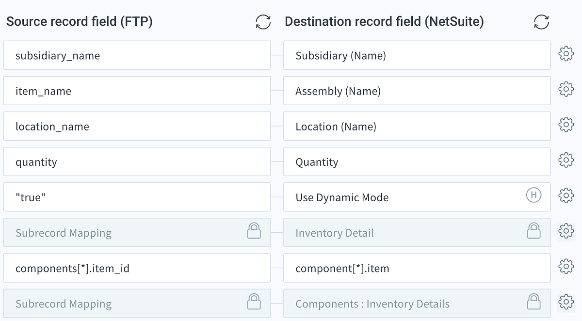

I've attached an example import configuration's screenshots to create an assembly build from assembly item. Please go through it and try similar for your import and do let us know if you need more help.
Sample export data in JSON:

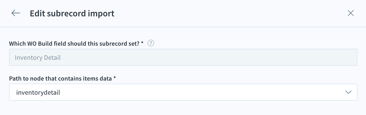

Subrecord path configuration for inventory detail subrecord (body level subrecord)

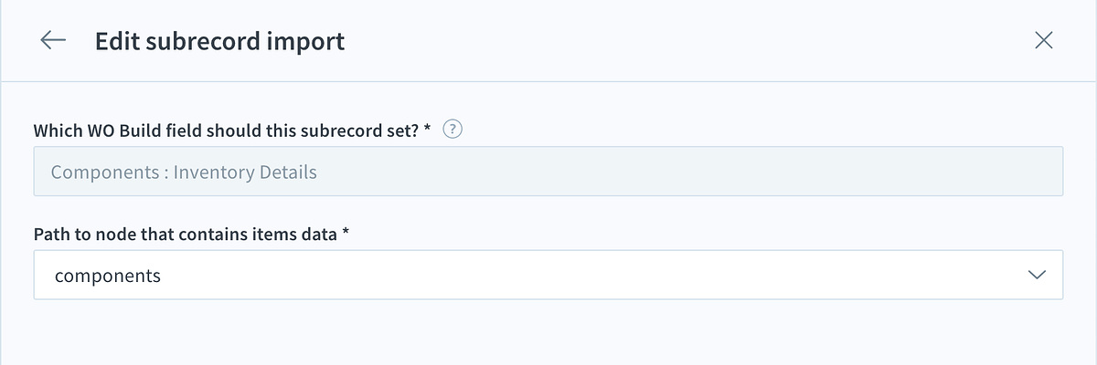

Subrecord path configuration for inventory detail subrecord (line item subrecord):
Main mappings:

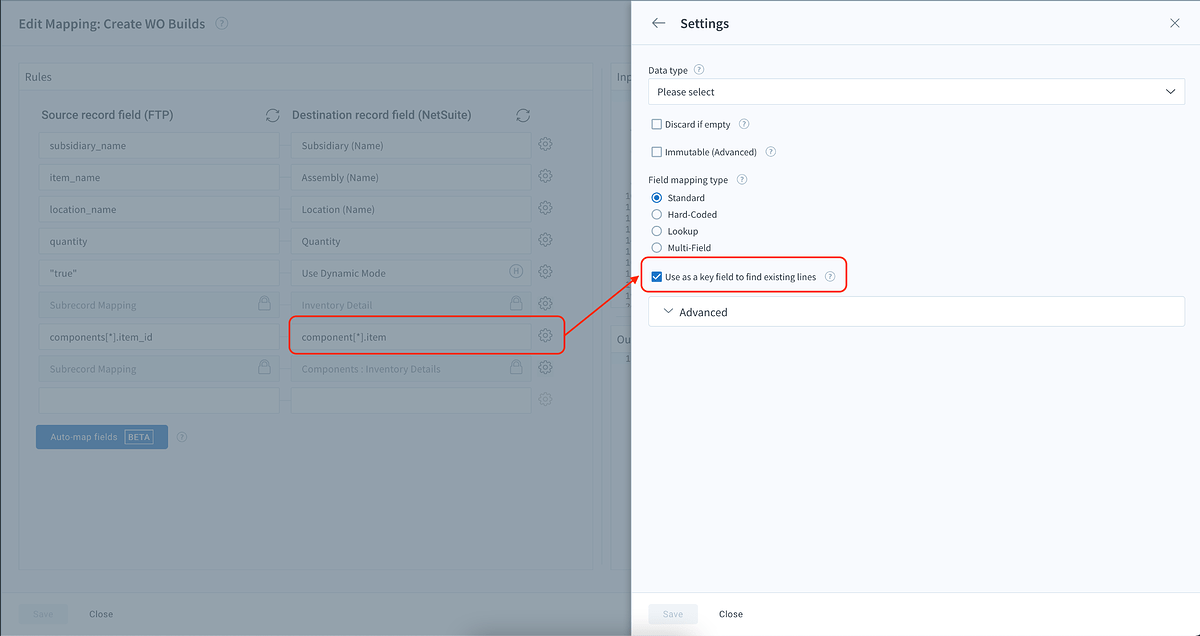

NOTE: component[*].item should be manually typed
Click the gear icon beside component[*].item and check the box as shown below:

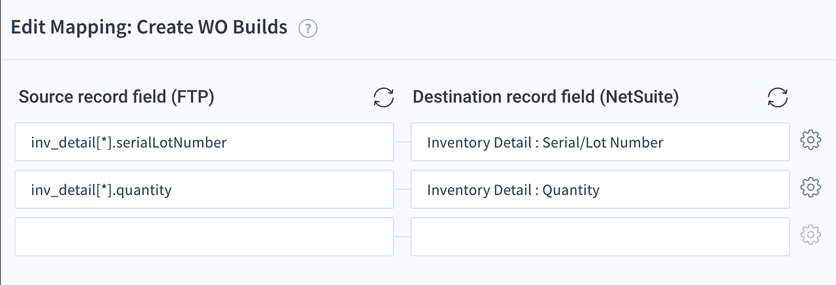

Subrecord mappings for body level subrecord field:
Subrecord mappings for line level subrecord field:

This worked for me, just one typo component[*].item should be components[*].item
Hi Rhys, glad to hear that you're able to get it to work.
May I know what error were you facing with component[*].item, because I'm fairly certain that it is not a typo.
HI Godishela,
I just noticed that it was referred to as Components : Inventory Details in the sub record mapping so I changed it from component[*].item to components[*].item. I don't think I actually tried it as component
