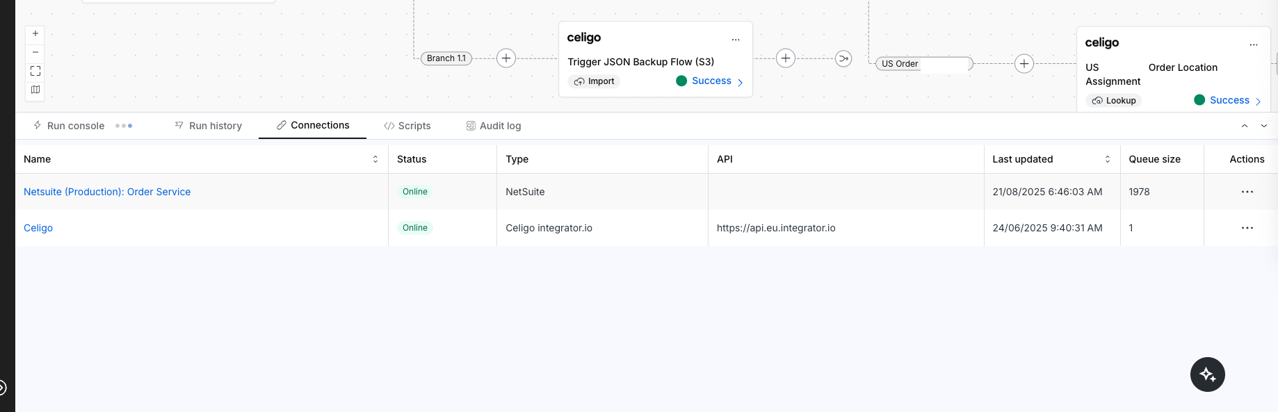

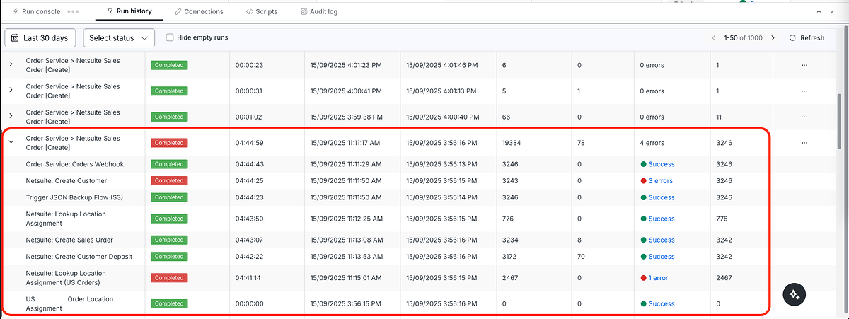

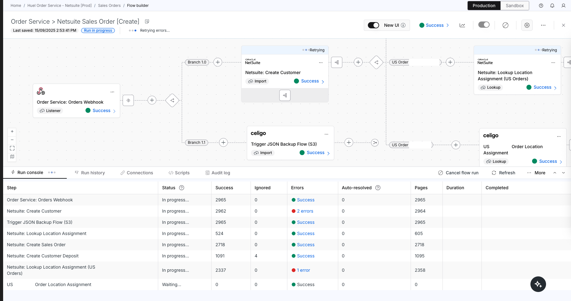

Most of the time the flow will process a small number of orders at a time, but there are times in the day where we have a large number of orders sent in a small window of time as we have subscription orders. Occasionally during these subscription order drops, the flow never completes an order before the next one is sent and can end up running for hours and hours which backs everything up - See screenshots

@Sam_Tuckett Could you check import settings including concurrency on that connection and if that connection is also shared across different flows ? It seems webhook events are getting captured here based on what you have described.
@bhavikshah I assume you mean the Netsuite connection? Yes we use this across multiple flows all relating to ecom order flow (orders, fulfillments, refunds). The concurrency is set to 10.

From conversations we have had since Friday, it seems that it is usual behaviour for Celigo to show the flow as “never ending” if we keep hitting the endpoint with more orders before it can complete the last run so I am less concerned, but I still think splitting the flow or batching up records as you have suggested would be a sensible option.

Yeah, if you have events firing to the webhook rapidly, then we just continually add them to the same job. How this technically happens is that all flows get a job made for them, and each step in a flow gets a child job made for it. If the child job of the first flow step is still open when the next event comes in, then the new event just gets added to the same job. However, even if it's added to the same job, it is its own page of data. Since pages in Celigo are the contracts sent between flow steps, prior events would have already moved down in the flow progress, even if we keep adding events to the same job.
We are thinking to eventually remove this job concept for event-driven flows since jobs are inherently batch-related versus event-related. For now, though, it's not really affecting anything besides causing confusion when you run into something like you're doing.
