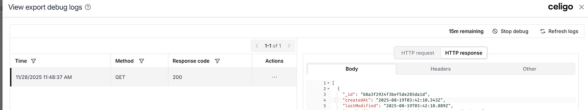

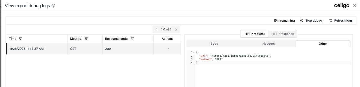

Most imports/exports have a "debug export/import" option and most connections also have a "debug connection." I would typically just use the debug import/export since the UI is nicer and it doesn't have other flows intermixed with the debug logs like connections. Connection debug can be helpful for those imports/exports that don't support debug logs. That being said, all of this will soon be much better when we release our new logging feature in the next couple of releases.
Thanks for your answer Tyler, I also used to enable the export/import logs for troubleshooting but the use case is: I want to know a specific request that was processed successfully yesterday, the flow was already released but the logs were not enabled. Is there any way to check that JSON request?
Thanks
That's not possible unless you had the debug enabled during that time. You could make a flow run report under Tools > Reports, then filter to the trace key/flow/integration/time period and see if the record you're referring to was processed at all. It won't show the request/response though. The upcoming enterprise logging feature would do this, but it also will be time-bound depending on your tier (I think 1-7 days).
