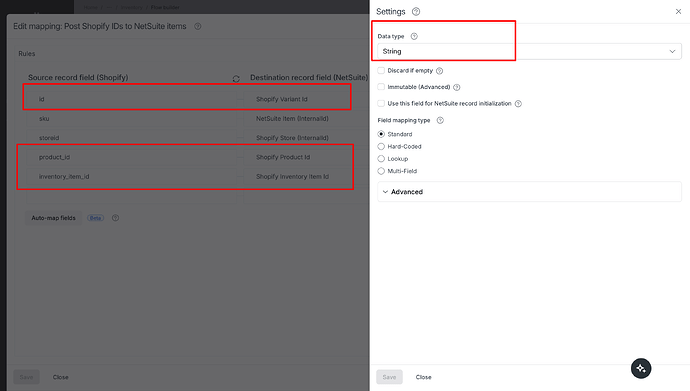

Hi @sravaninuagesync,
I think you're on the right track but a few things to double-check:
  • Record Type: Celigo Shopify Item Id Map
  • Operation: Add or Update
  • How to find existing records: Ensure this setting is configured correctly
Common mistakes we usually encounter when building custom flows for this use case:
  • Ensure SKU is unique and not empty or null
  • Avoid applying filters in the Import orchestration/bubble during initial development—keep it open until you achieve a successful run
  • Most importantly, ensure the Data Type is set to String for the following fields (commonly missed):
  • Shopify Variant Id
  • Shopify Product Id
  • Shopify Inventory Item Id
Let me know if that works or if you can share you connection debug logs after above verification i can further help as well.
