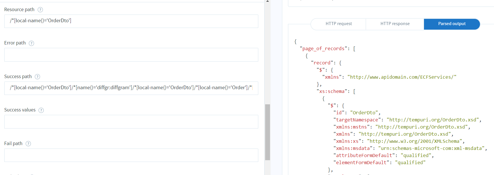

Hi Hristina,
You will need to account for the namespaces.
Resource path -
/*[local-name()='OrderDto']
Success path -
/*[local-name()='OrderDto']/*[name()='diffgr:diffgram']/*[local-name()='OrderDto']/*[local-name()='Order']/*[local-name()='OrderId']
Thanks,
Anirudh

Hello @mattgraney-Matt-Graney" rel="nofollow noreferrer">Matt Graney,
Here is the "HTTP response | Body" panel.

Andthisisthe"ParsedOutput"panel.
"page_of_records":[
"record":{
"xmlns":"http://www.domain.com/ECFServices/"
"xs:schema":[
"id":"OrderDto",
"targetNamespace":"http://tempuri.org/OrderDto.xsd",
