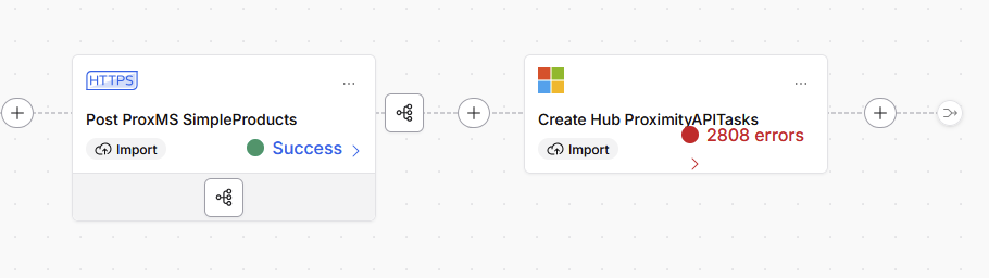

One more related issue. In the next step I want to capture some info from the batch HTTP response. It may send a few thousand records in the HTTP request, but I just want to capture a few field values in a SQL table. I captured the response fields in the response mapping. I have set the step to “Use SQL query on the first page only”. Everything looks like it should work in the SQL preview window.
I have 2 issues. First I am getting 2808 errors, when I would expect to only execute the SQL statement once (at most 1 error). Second, when it runs it tells me that taskId is not defined in the model.

My flow sends 2808 records all together as 1 HTTP POST.
The API that I am posting to returns a few fields in the response (see debug log below).
I want to capture and save those fields as 1 record in a SQL table (1 record for the batch of 2808).
I have the SQL step set to “use SQL query on first page only”, and you can see the preview below.
However, when I run it I get 2808 failures that say the taskId is not part of the model. I would expect at most 1 error, and taskId works fine in the preview.
Much more clear thanks Jim. When running the "Use SQL query on the first page only", it's a batch so when we get a failure from the batch, we apply the failure to all records within the batch. We are wanting to enhance error management so this sort of thing could then be grouped in the UI and be more manageable (@priyankakoundal is working on this).
