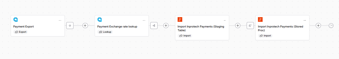

You are quite right. This screen shot was from my first step that looks to populate the staging table. The next step then calls the stored procedure. So my approach will be to add the detail rows to the staging table in the first step and then execute the stored procedure with a single row for the header that is passed to the stored proc and will run some validations and then create the transaction header in the database following be processing the details rows from the staging table. I think that should achieve what I need and also allow the transaction to rollback and report and error should any validation errors be encountered by the stored proc.

Hi @tylerlamparter I was able to get the flow operational but was hoping to improve the logic by including a unique identifier for the current flow so that this could be saved as a column in the staging table. So I use handlebars to derive the JobID which all works well until I then try to pass the same JobID into the stored procedure in the subsequent step to help identify the rows to process from the latest execution of the flow. It looks like each step is allocated a different JobID. Is there something I can use that will allow me to identify the specific execution of the flow and pass this between the 2 steps? At the moment I have a workaround to clear down any duplicated data as a prior step but would ideally like to retain the staging data as a further audit trail for problem diagnostics. Any suggestions appreciated.
Use {{{job.parentJob._id}}}. All flow steps get their own child job (which is the ID you're referencing), and all flow runs get the parent job ID, which would be the same between flow steps for that run.
Thanks again Tyler, worked like a charm! I did look at the parentJob ID but thought it was the ID from the previous step so I was comparing it to the JobID of the prior step. Using the parent ID in both steps was what I missed.
