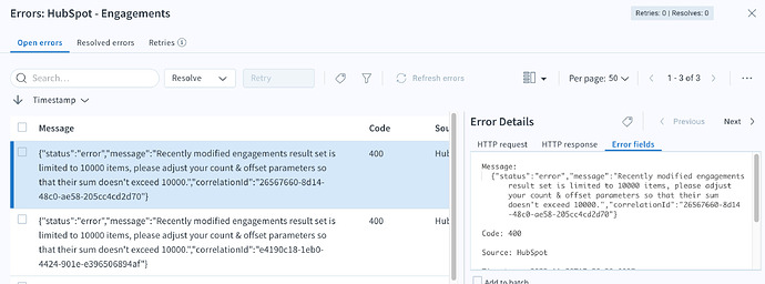

I am trying to export out of HubSpot using the "Recent Engagements" API and consistently receiving the same error. I have set the UNIX timestamp to today (1700460000) to try to limit the data but still receive the same error indicating that too many records are being pulled. Theoretically, I only need "MEETINGS" and have set an output filter as such, but the issue is that before I get to this step the export is trying to pull all engagements (i.e. tasks, calls, emails, meetings, etc.). Is there a way to limit this down to just pull meetings and thus hopefully a lot less records on the export?
Hey @daveguderian, I see Hubspot recently updated their Engagements API to v3. Our Hubspot connector does not have this update yet but you can switch the Form Views on the export to use REST API. Hubspot now has a /meetings endpoint which would limit the data coming in. Hopefully that gets you to what you need. I will also request to have our Hubspot connector updated to show the updated APIs via the drop down!
