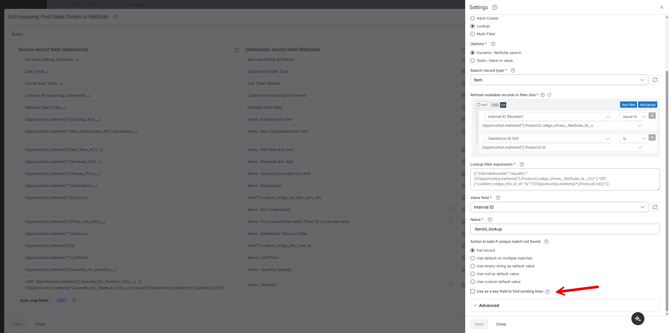

I’m trying add or update the Netsuite Sales orders coming from the EDI. Currently I have the mapping for Netsuite it has items: create lines, now if I add replace all lines for items at the bottom of mapping the fields will it update. Say I created a SO with 3 items, now I include add or update option and add the mapping replace all lines and sent EDI message with 2 items will it replace all items and update the SO with only 2 items?

yes, when you use the replace all lines for item mapping then all the existing lines in the order will be removed and the order will create with lines which are present in the current data.
If you use the "Use as a key field to find existing lines" option within a sublist mapping, then it will use that field as the key to determine if a new line should be created or an existing line should be updated.
If you use the "Replace All Lines" mapping, then all lines on the current sublist will be removed and replaced by what you've just sent to it.
Hi Tyler,
I’ve found recently that the combination of replace all lines and Use as Key Field will not remove/replace all lines when you doing a transformation. It’s oddly convenient. I had the use case of needed to create a partial Credit Memo from an Return Authorization. Using the above combination removes the lines that are not “updated” by the flow. This may only apply on transformations. I’m not sure.
