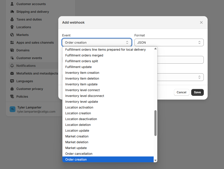

              Shopify only supports webhook filtering via API — there’s no UI option to apply filters when creating a webhook. You can update the webhook with filters using a tool like Postman, but honestly, it’s probably better to filter the data in your Celigo flow instead.
Filtering in the flow is easier, more transparent to other users, and avoids confusion since Shopify’s webhook filters aren’t visible in their UI and can easily be missed.

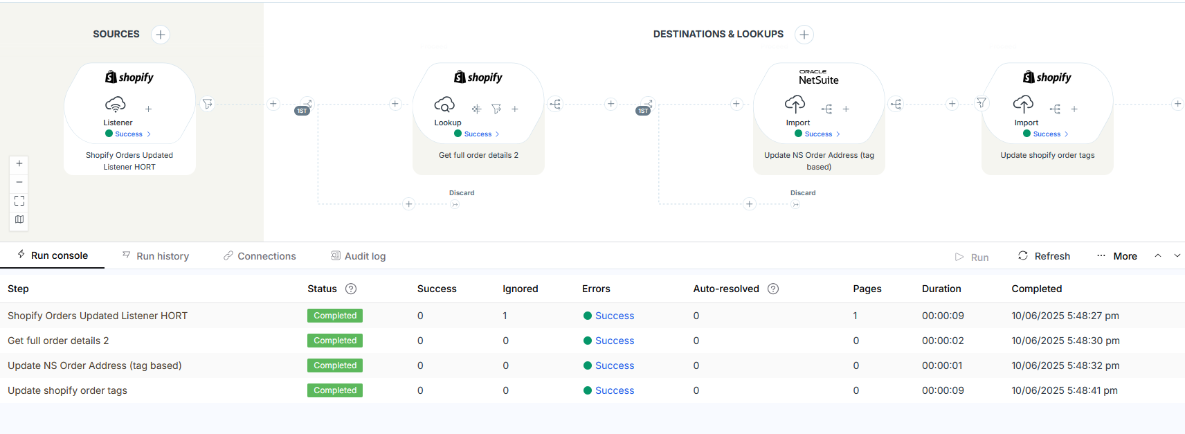

I have currently got an output filter on the listener (to exclude closed orders) and then also using branching to further reduce processing. It currently looks like:
Step 2 looks for order comments that include "updated the shipping address for this order" adding a results mapping "PROCEED" - which is used conditionally at the branching to step 3 (updates the address in NS) - and finally step 4 adds a further tag to the order in Shopify (Address_Updated_NS) - which in turn is then used as an output filter in step 1 (to prevent the same address change being updated each time the order is edited in Shopify).
I think this works. I would be open to any ideas how further to improve this. My concern is that for every order that is updated in Shopify - they ALL go through this flow and each step runs, albeit with no data. You will see in the image that the flow took 20 seconds to run on an order that was updated but was filtered out at the first stage.
Is this OK? To have a flow that will be triggering and running so much? If we are processing 1000s of orders a day is that still ok? Should I be concerned about API call limits, concurrency, execution time....?
              If most records are filtered out by the webhook output filter, then I wouldn't be concerned about performance here. If you are having to hit the lookup step often, then I would potentially be concerned, but I'm not sure if there is another option. In the payload that Shopify sends for it's webhook, does it not include the comment data? It would be nice if the webhook just passed it because then you wouldn't need a lookup at all.
