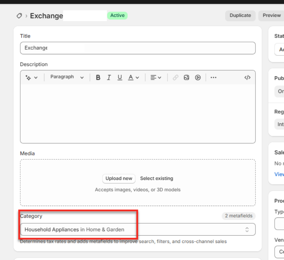

Test 1: Product Category is hardcoded
Mapping:
Results:
