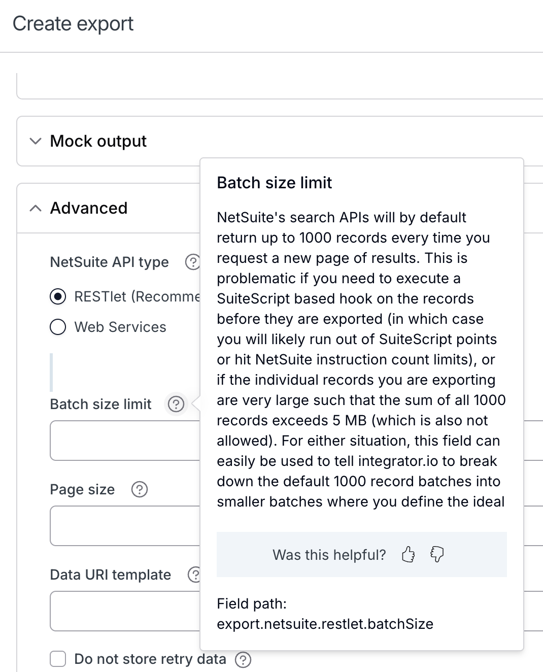

Try decreasing the batch size under advanced and try removing fields you don’t actually need.
NetSuite's search APIs will by default return up to 1000 records every time you request a new page of results. This is problematic if you need to execute a SuiteScript based hook on the records before they are exported (in which case you will likely run out of SuiteScript points or hit NetSuite instruction count limits), or if the individual records you are exporting are very large such that the sum of all 1000 records exceeds 5 MB (which is also not allowed). For either situation, this field can easily be used to tell integrator.io to break down the default 1000 record batches into smaller batches where you define the ideal size.
Hi Tyler, this is great advice thanks. I’ll give it a try and see if sorts things out.
I can confirm I’ve had no errors since making the changes to the batch size limit. Thanks again for the help!
