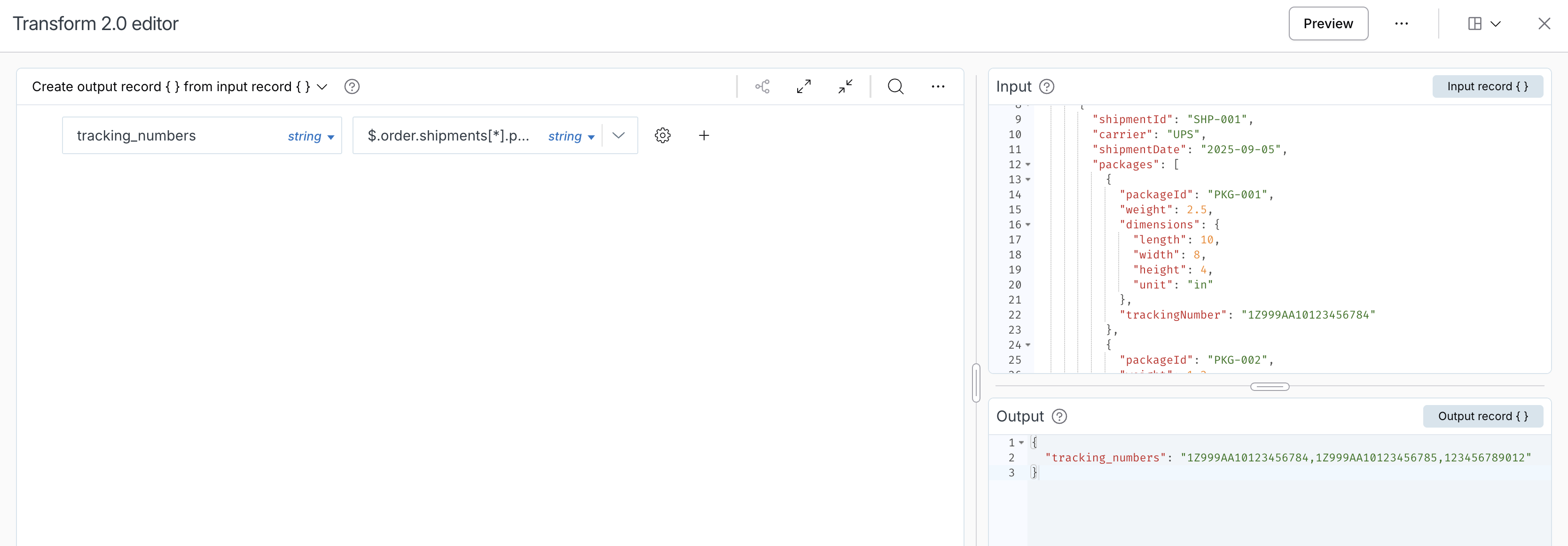

In this example, you might just be able to use mapper 2.0 when you need to send them to your final destination (I'm not sure where you are going with this data).
Mapping:
$.order.shipments[*].packages[*].trackingNumber
Sample data:

You could also use handlebars later within mapper 1.0, mapper 2.0, or some other AFE editor where you need this.
{{#each order.shipments}}{{#each packages}}{{trackingNumber}}{{^if @last}},{{/if}}{{/each}}{{^if @last}},{{/if}}{{/each}}
