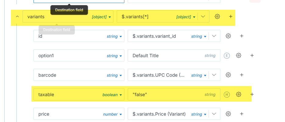

Hi Kelly,
Can you try adding the mapping under the variants object as shown in the screenshot below?
Ensure that the Destination Field Type is set to Boolean. You can set the Source field as needed.
Hi Thank you I did try it that way and it is still not changing the Boolean :frowning: here is my screenshot please let me know if you see anything wrong
