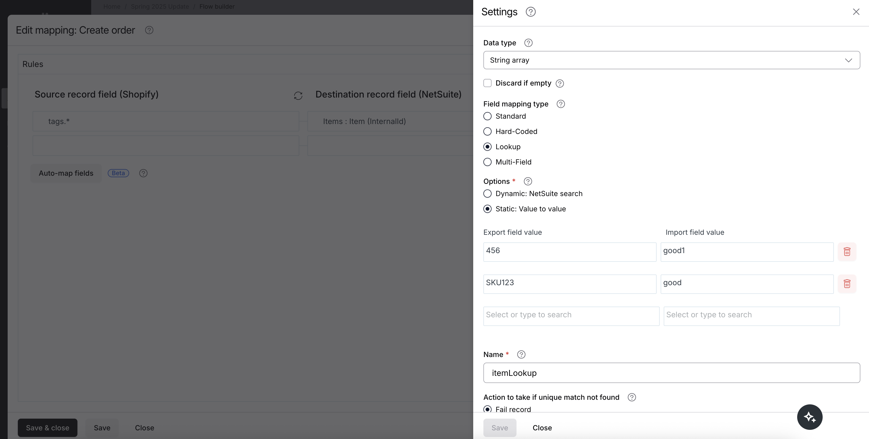

Took me a few tries, but this is working for me. I didn't try with dynamic mapping, but this should work for that as well.

Unfortunately, it doesn't look like this will work. This does work if the destination record field is a sublist field, which is what you are showing. I confirmed this does work myself. But it doesn't work when the destination field is a body field that is multi-select type in Netsuite. I neglected to include that point, which seems to be the unsupported point that I am stuck at.
Unfortunately, I hit a roadblock as well. I was attempting to use each Handlebars with compare blocks, but it seems the compare block will force exit of the else block when something is evaluated to true. I don’t think it does this when it’s a mapping to a sublist, but since you’re going to a body field, we would need this added functionality. We are working on many Handlebars enhancements, so I’ll get this on the list.
