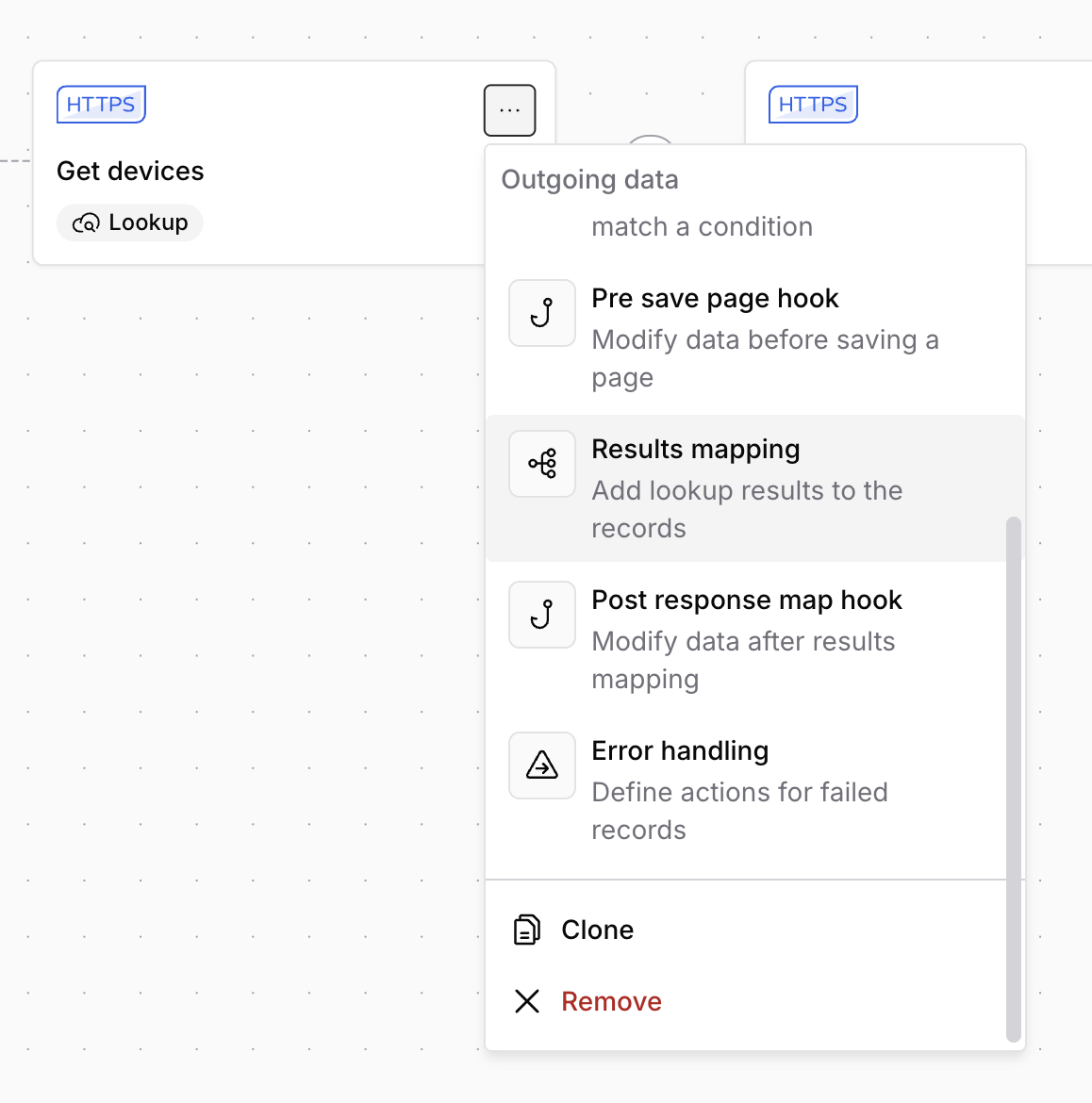

  3. Iterate through the returned active devices and make a seperate call to retrieve the odometer reading (can’t get the device list to pass down the flow)

Please add results mapping on the lookup step , to merge the list of all active devices received into the record exported.
Click on 3 dots on the lookup step , in the list select results mapping
Add results mapping
You can read more : https://docs.celigo.com/hc/en-us/articles/360054647472-Lookups-and-results-mapping
