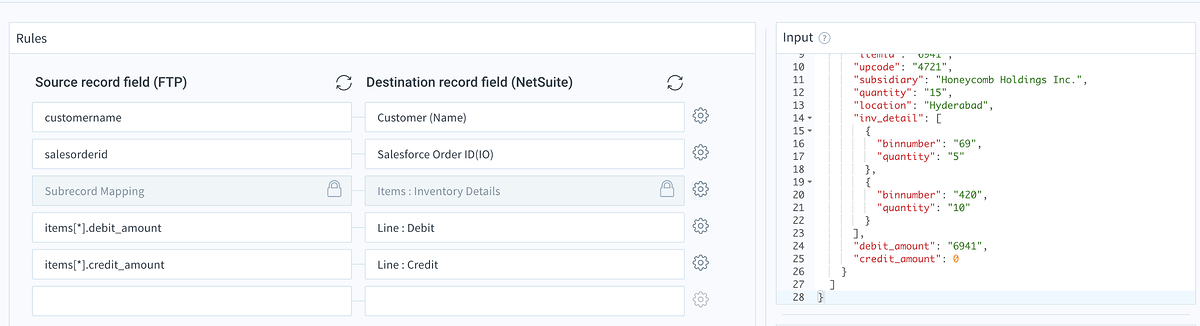

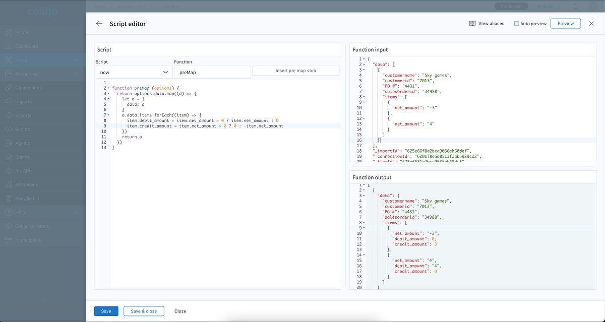

The handlebar expression seems to be working only for body level fields and not for line level fields. I suggest you to configure a simple preMap hook script which generates 2 fields (debit_amount and credit_amount) with desired values which can be mapped directly without the need of handlebars.
Please refer to the attached screenshots. To learn more about hooks, please go through this article.
Script Code:
function preMap (options) {
return options.data.map((d) => {
let o = {
data: d
o.data.Lines.forEach((line) => {
line.debit_amount = line.Net_Amount > 0 ? line.Net_Amount : 0
line.credit_amount = line.Net_Amount > 0 ? 0 : -line.Net_Amount
return o
Let us know if this works for you.
Hi @sachingoud-Godishela-Sachin-Goud" rel="nofollow noreferrer">Godishela Sachin Goud ,
The Hook is working for me and I am successfully able to post the records and create Journal Entries. Thank you so much for investing your valuable time and providing me with the solution.
