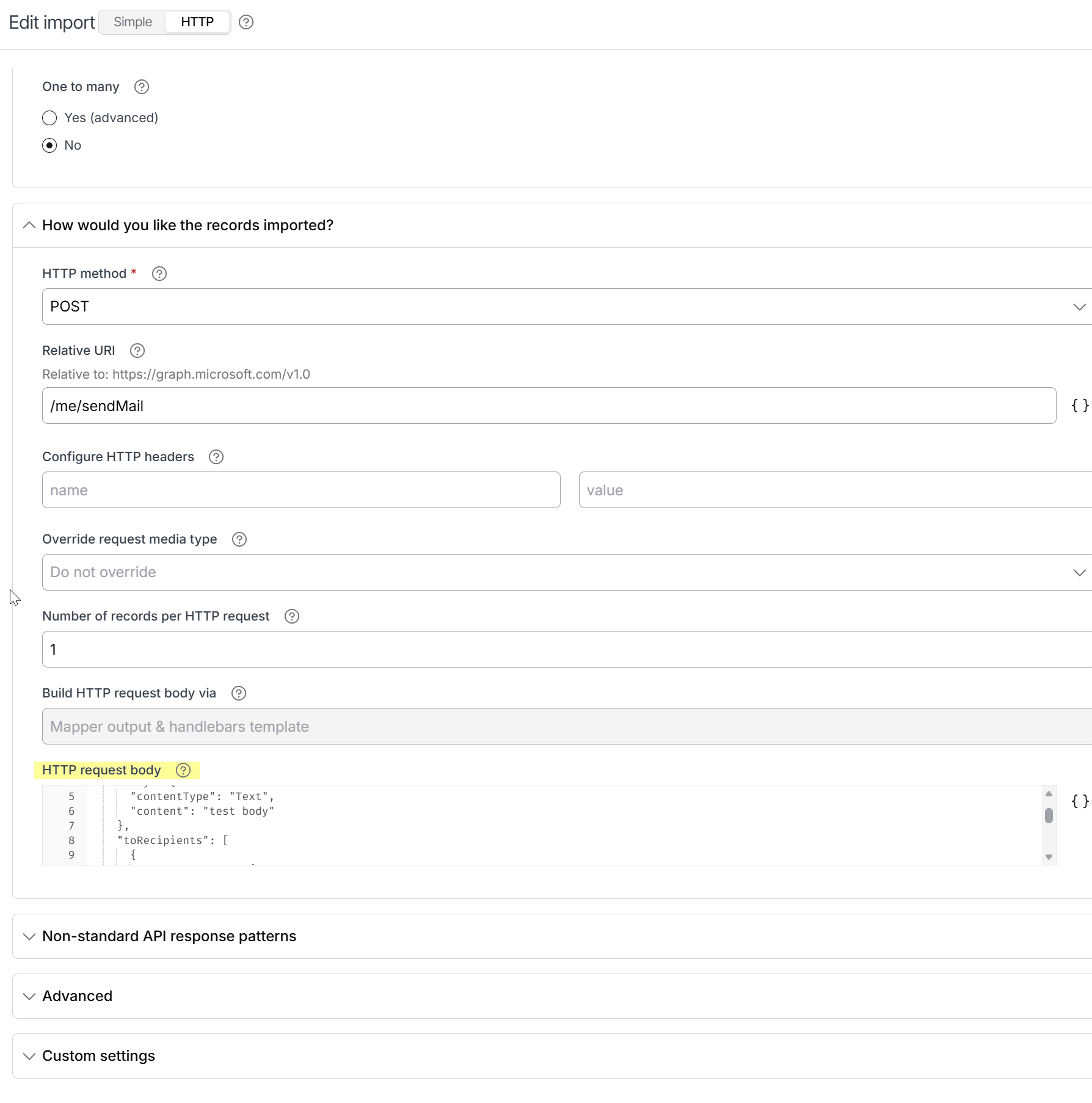

This can be accomplished by sending [attachments] in the API request body with the Outlook connector. For this, the attachment content will need to be base 64 encoded. Here are the basic steps:

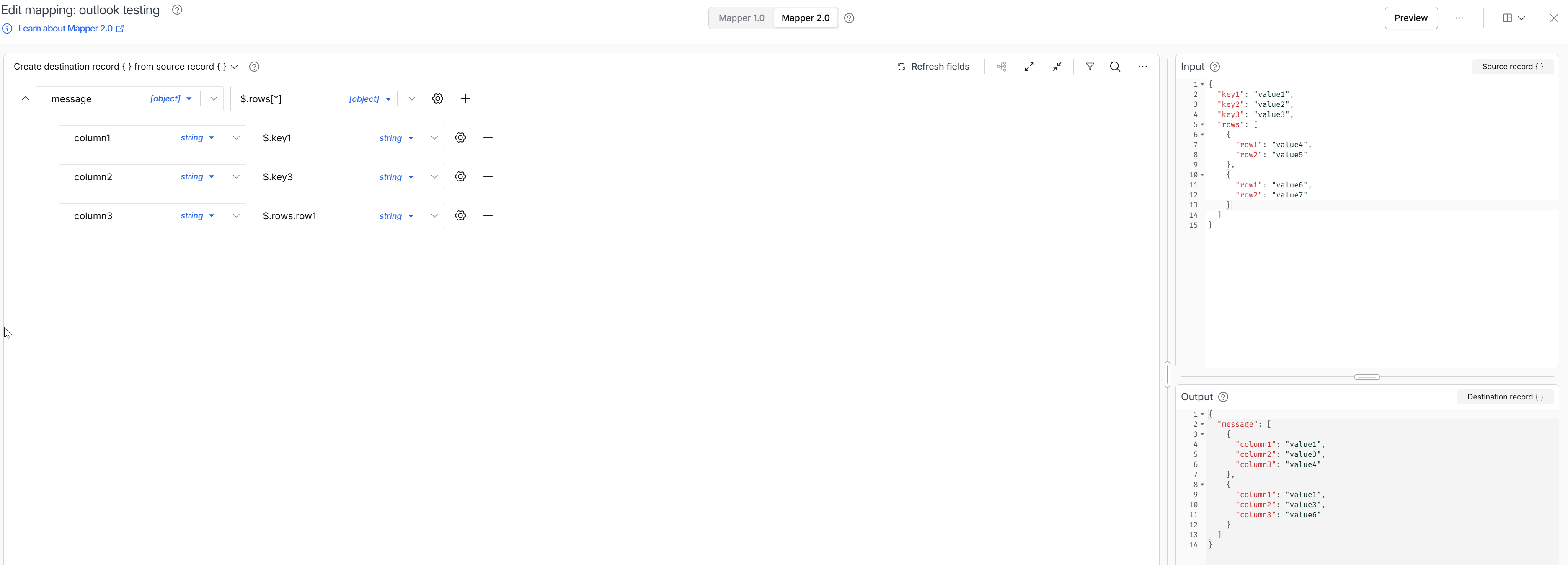

The desired content of the csv will need to be in our json data. There are many ways to accomplish this, but a simple method is to use the import step’s mapping. Note that despite the general setup of this mapping, it will not actually be what we use to create the email subject, body, or recipient.

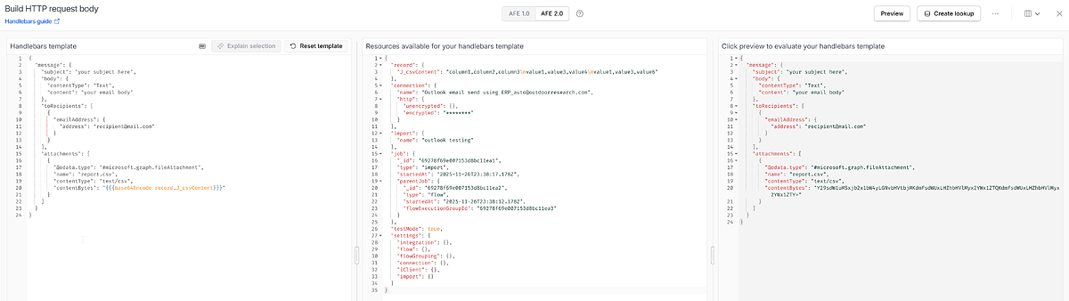

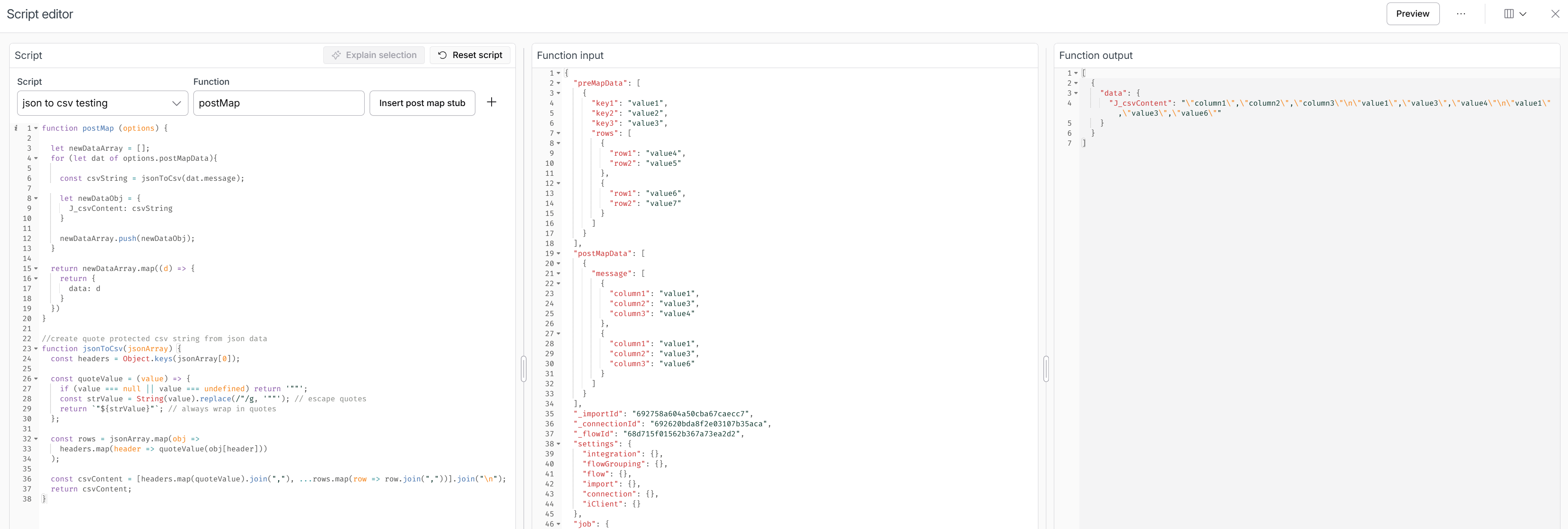

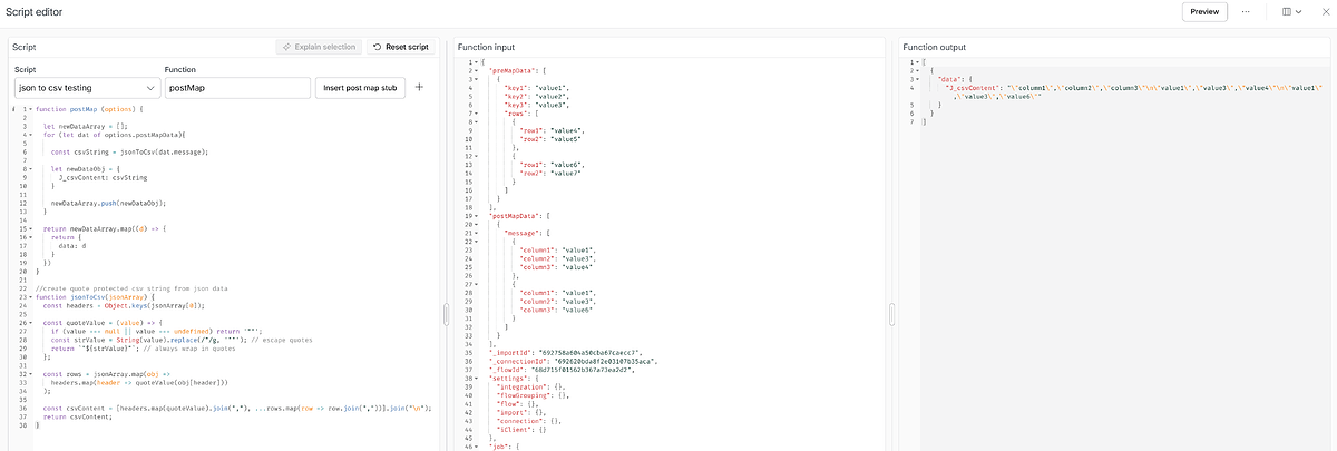

For the attachment functionality with Outlook’s Microsoft Graph API (other email providers may function differently) we want the attachment contents to be base64 encoded. We will use handlebars for the encoding, but we’d then want the desired csv contents to be in a single json value. A j hook can be used to accomplish this.

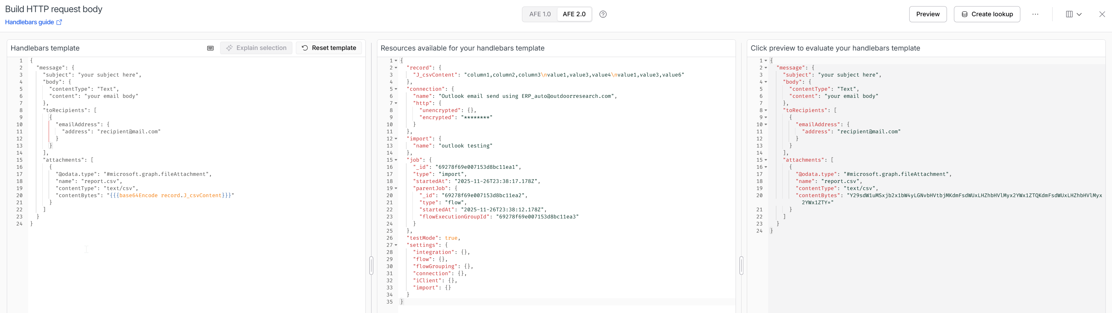

We used the regular Celigo mapping tool to create the CSV, we then override it by editing the HTTP request body. Note the handlebar helper used to encode the csv content.

    • Your solution; but it could be tweaked to set "Number of records per HTTP request" to say 10,000 and set your export page size to 10,000 so your postMap script could actually aggregate all records in the page to a single CSV (you'd have to aggregate all preMap data into the first returned postMap data object), then reference that 1 new field in the HTTP request body by referencing batch_of_records.0.record.J_csvContent. You could also convert the data to a base64 encoded string by using the sjcl library (https://docs.celigo.com/hc/en-us/articles/10022695264539-Access-the-sjcl-JavaScript-library-in-scripts).
