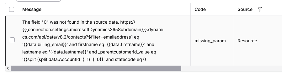

However, I am struggling with an error returned when I try to use the returned value in the next step as part of the composite lookup filter. I am getting the error below.
The field ""1")" was not found in the source data. https://{{{connection.settings.microsoftDynamics365Subdomain}}}.dynamics.com/api/data/v8.2/contacts?$filter=emailaddress1 eq '{{record.billing_email}}' and firstname eq '{{record.firstname}}' and lastname eq '{{record.lastname}}' and parentcustomerid_account eq '{{substring record.AccountId (subtract record.AccountId.length "37") (subtract record.AccountId "1")}}' and statecode = 0

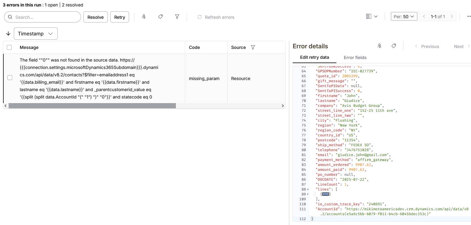

And here’s the error with the retry data. The AccountId looks like it’s there in the retry data.
Even though the AccountId field looks like it’s there in the retry data, the error seems like it’s having trouble finding it. If I replace the whole handlebar expression with a hardcoded GUID, it runs fine.

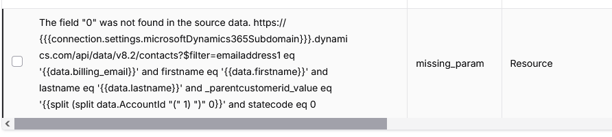

What if you try:
{{split (split record.AccountId "(" 1) ")" 0}}
or
{{split (split record.AccountId '(' 1) ')' 0}}
or
{{split (split record.AccountId '(' '1') ')' '0'}}
Your first suggestion works fine in the preview window. I don’t think it’s the handlebar syntax.
The reason I ask to test these variations is that I've seen cases where it's being incorrectly evaluated, and sometimes switching between single and double quotes resolves it until we can fix the bug. Additionally, the docs show the index as an integer, so I figured it's also worth a shot. Let me know if all three fail.
Also, is this handlebar on the lookup section of the composite API?
Yes, it’s in the lookup section of the composite API.
I tried it without the “ around the numbers, and same result.
Can you try the single quotes around parentheses as well?
What if you try:
{{regexMatch (regexMatch data.AccountId "\([^)]*\)" 0) "[^()]+" 0}}
or
{{regexMatch (regexMatch data.AccountId '\([^)]*\)' 0) '[^()]+' 0}}
All of the scenarios I've provided are working for me in the composite lookup step. I'd suggest opening a support ticket and provide them this thread.
Same result with those. I will open a support ticket.
