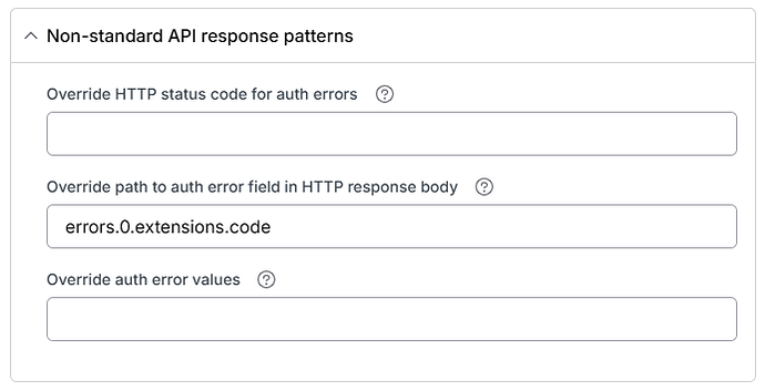

…and here are the “Non-standard API response patterns” settings I have set up in my GraphQL Connection:
If somebody could point me in the right direction, I’d appreciate it! Thanks!
Welcome! Could you try not putting anything in "Override HTTP status code for auth errors", and changing your path to errors.0.extensions.code?
I made that change, but sadly no luck:
I also tried changing the path and setting the HTTP status code back to 200, same result.
Hmm, that should work if that's the response being returned. What if you remove the value for "Override auth error values"?
How this section is supposed to work is like this:
  1. We first check if you have something specified for status code override. If you do, then we check if the status code returned matches the status code you specified, and if it does, then we recognize it as an error. So for this, we don't look at the fail path.
  2. If, after checking the status code, we still haven't identified an error, we check the fail path. If there is something in that fail path, then it should be marked as a failure.
  3. Lastly, if you also have error values specified, then we check that the value in that path matches the value you specified.
