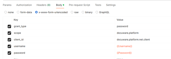

I am trying to build the connection to Docuware. It uses the OAuth2.0, grant type password, sent in request as http body which is x-www-form-urlencoded.
In Postman I've successfully tested the request with http header Content-Type: application/x-www-form-urlencoded and parameters set as on a below screenshot and retrieved the access_token in a response from token URL.

In Celigo I defined OAuth2.0 iClient with the same token URL and overriden the request body as JSON:
My override http body in Celigo:
"grant_type": "password",
"scope": "docuware.platform",
"client_id": "docuware.platform.net.client",
"username": "{{{iClient.oauth2.username}}}",
"password": "{{{iClient.oauth2.password}}}"
