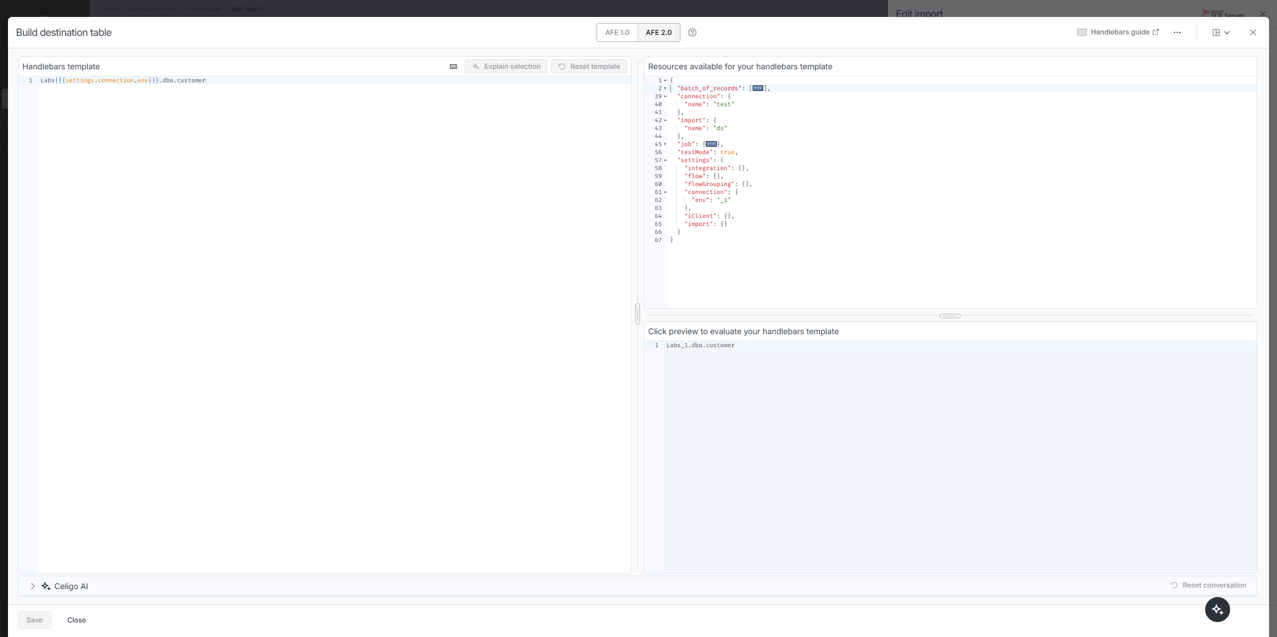

I think that's only a preview error due to the handlebars not being evaluated prior to attempting to fetch table metadata for mapper. Can you verify it works fine for runtime?
That error is what appears when it is run. It looks like it thinks it is a temp table, unless “#” means something else than I’m accustomed to …
Same thing works though if you just hardcode in _dev?
Correct, I usually don’t have the data bracketed, but it works just fine with ipaas_dev. … It’s like when it sees the {{{ it changes it’s MO.
I just tested in my environment and it's working fine. I'd suggest making a ticket so support can troubleshoot further.
It works when previewing in the handlebars editor for us also. Were you able to get it to actually run the flow and work?
Yeah it worked in preview and runtime for me.

4a. When referencing the table, if inside SQL: from [ipaas{{{settings.connection.Environment}}}].[table_name] (brackets are optional), this would give me [ipaas_dev] in Sandbox and [ipaas] in Prod.
4b. If this is a Destination table in Celigo, you CANNOT use brackets, mine looks like databasename.ipaas{{{settings.connection.Environment}}}.table_nameyou won’t be able to see anything in preview, etc. so I would suggest hardcoding it to set-up any Mapping and then changing it to the above option so you can see your actual table names.
